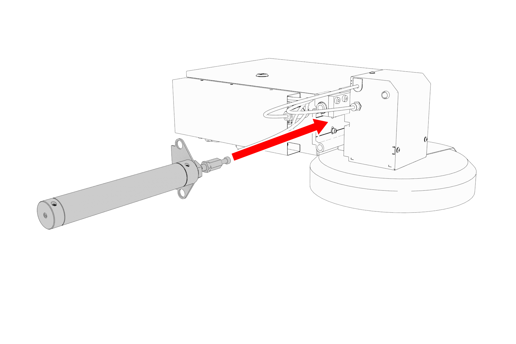

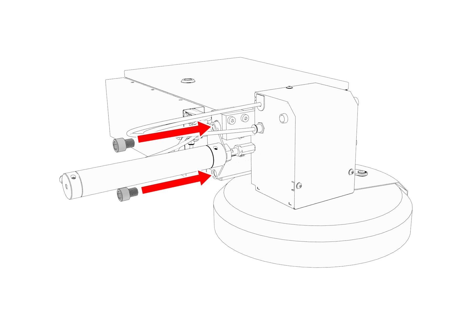

Install the Air Cylinder
    Putting the air cylinder into the ATC main assembly.
  2. Secure the air cylinder to the ATC main assembly with a 12 mm hex wrench (provided) and two M14 × 20 mm socket head cap screws.
    Putting the air cylinder hardware into the air cylinder.
  3. Connect the air lines from the ATC main assembly to the air cylinder as follows:
    • Connect the short air line to the front of the cylinder.
    • Connect the long air line to the back of the cylinder.

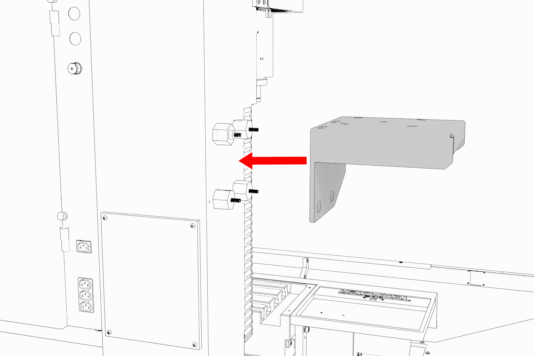

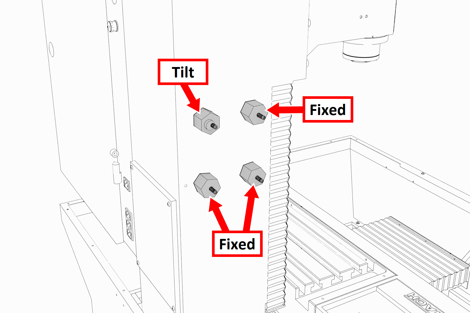

Mount the Automatic Tool Changer Bracket
    • Three fixed standoffs
    • One tilt standoff
    Four standoffs installed on the Z-column.
  5. Securely tighten the standoffs on the Z-column with a 1-1/2 in. adjustable wrench.
  6. Put the ATC mounting bracket on the standoff's threaded studs as shown in the following image.
    ATC mounting bracket moving on to the four standoffs.
    Verify that the tilt standoff's eccentric cam fits into the large slot on the ATC mounting bracket.
  7. Secure the bracket by reinstalling the washers and flange nuts that you removed in Step 2 with a 13 mm socket.
  8. Pull the bracket toward the front of the machine. You'll make adjustments to the location of the bracket later in this procedure, but we recommend starting with it moved forward.

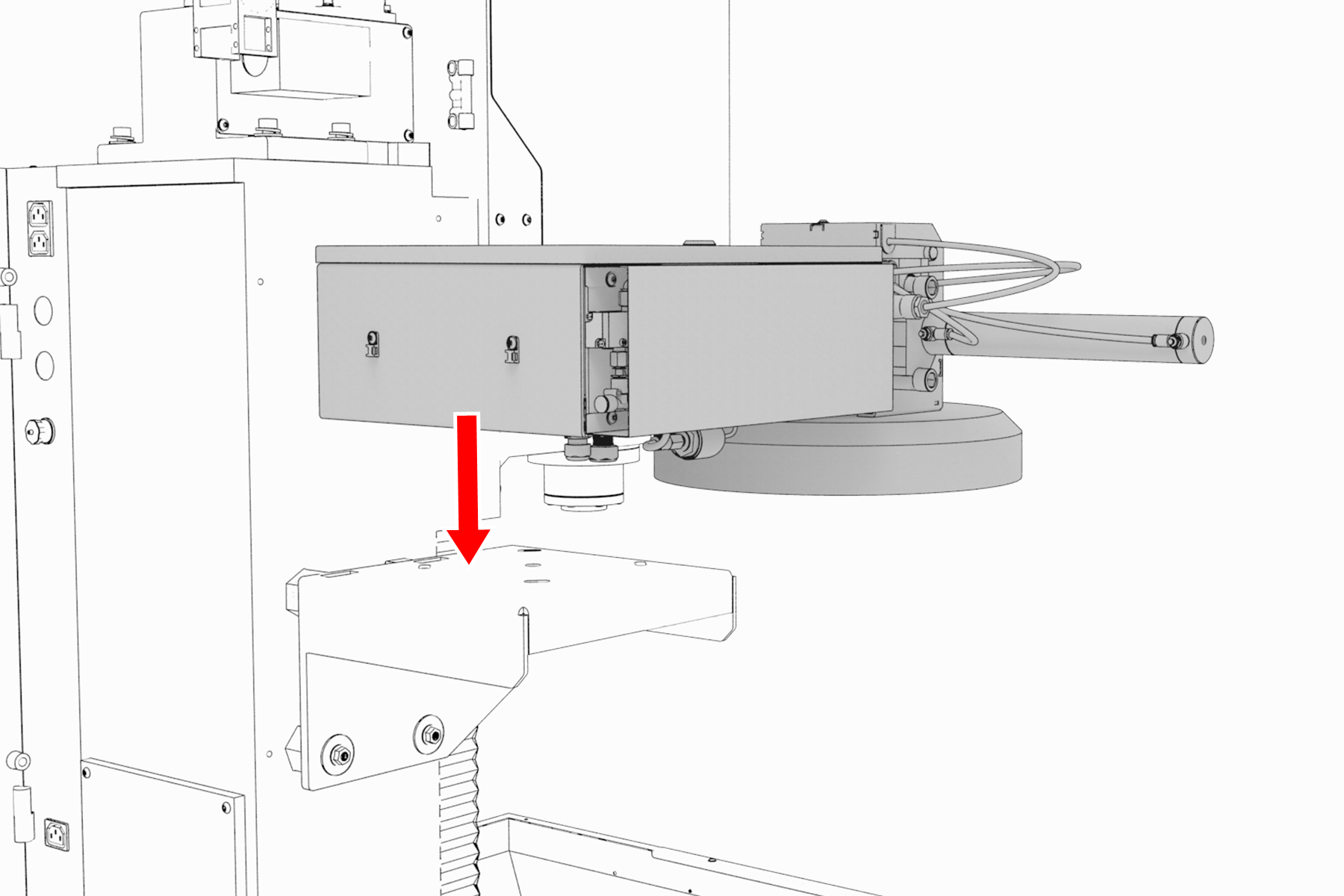

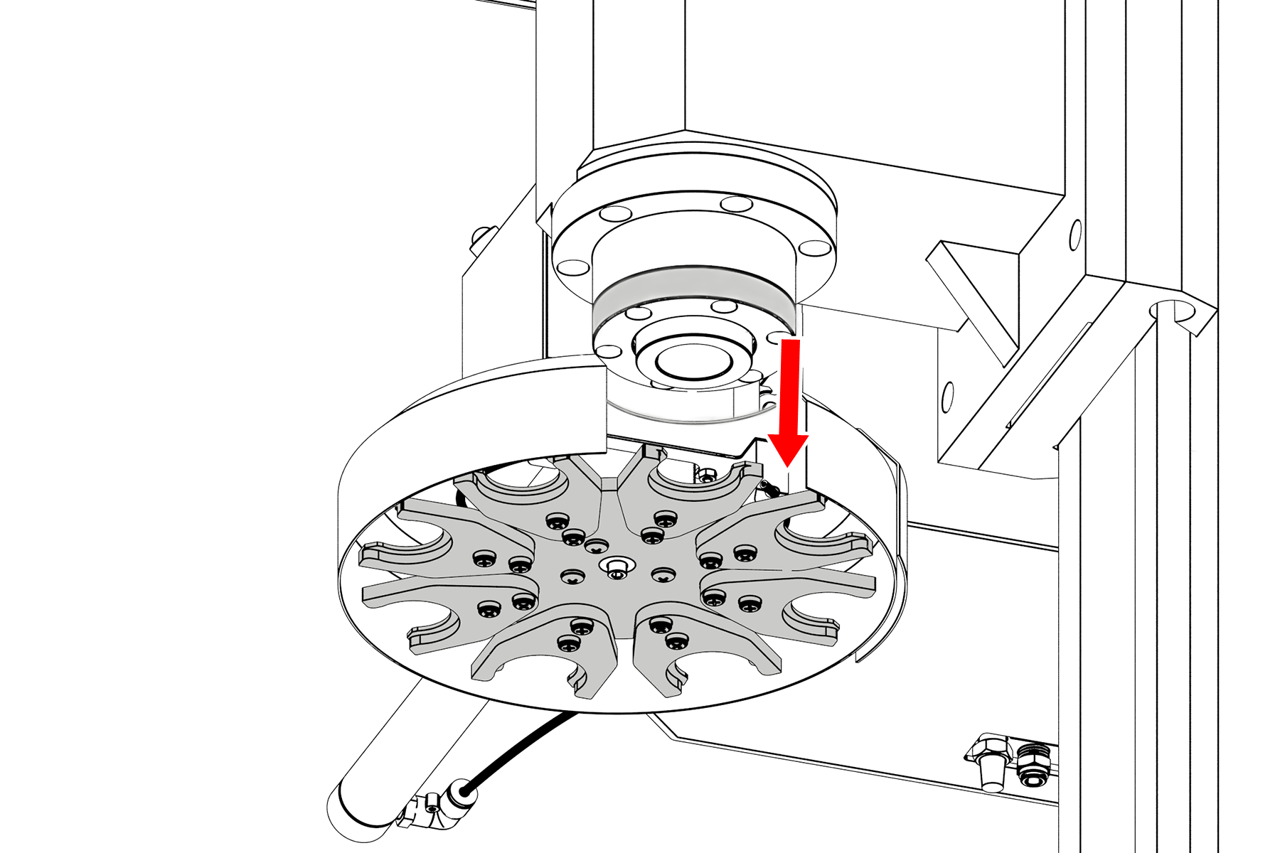

Install the Main Assembly
    Team Lift Required: You must have the aid of more than one person to lift and move the object. The object is heavy, and lifting it by yourself can cause serious injury.
  2. Lift the ATC main assembly on to the mounting bracket.
    ATC main assembly positioned above the mounting bracket.
  3. Align the locating pin on the ATC main assembly with the matching hole in the mounting bracket.
  4. Secure the ATC main assembly to the mounting bracket with the four M8 × 1.25 - 16 mm socket head cap screws and washers that you set aside in Step 1.

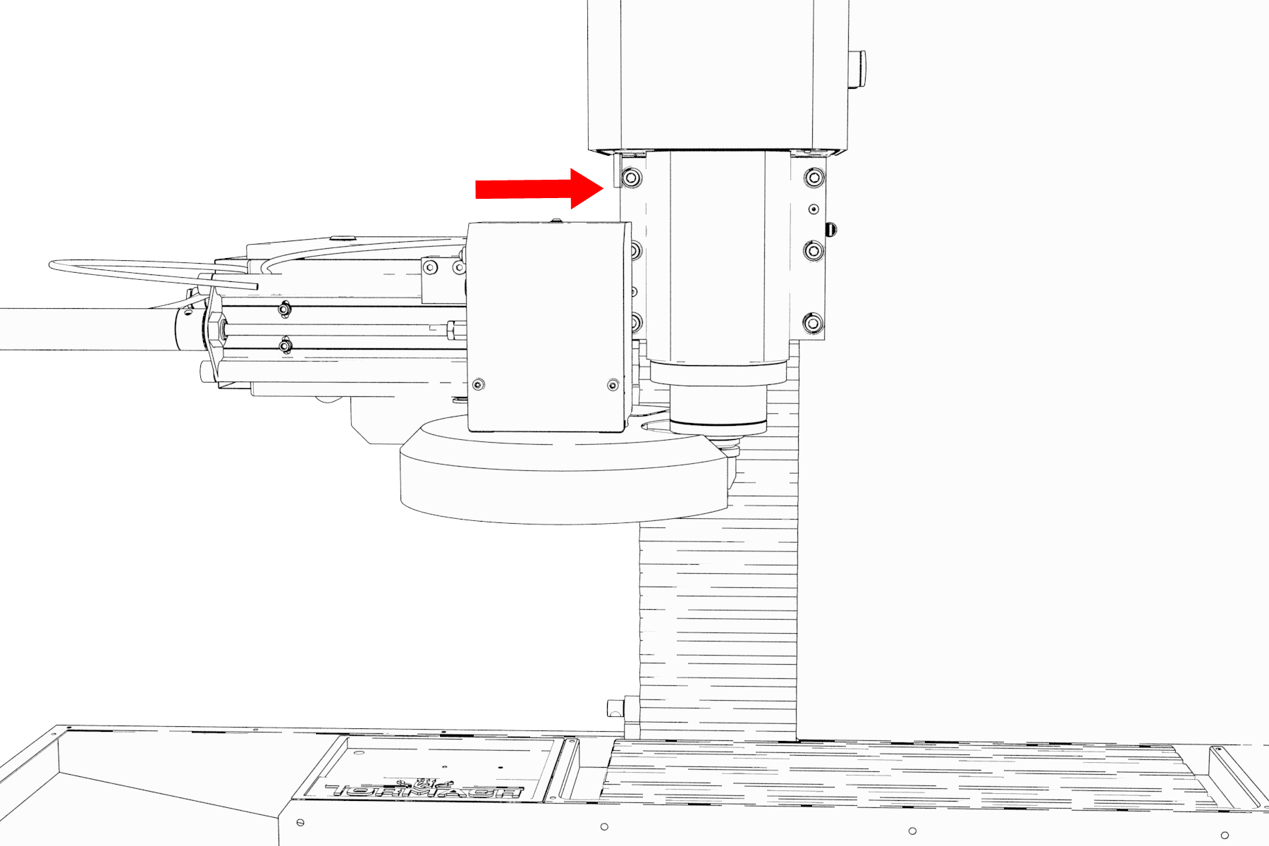

Level the ATC
Prepare the Machine
    Tool tray moved in toward the spindle.

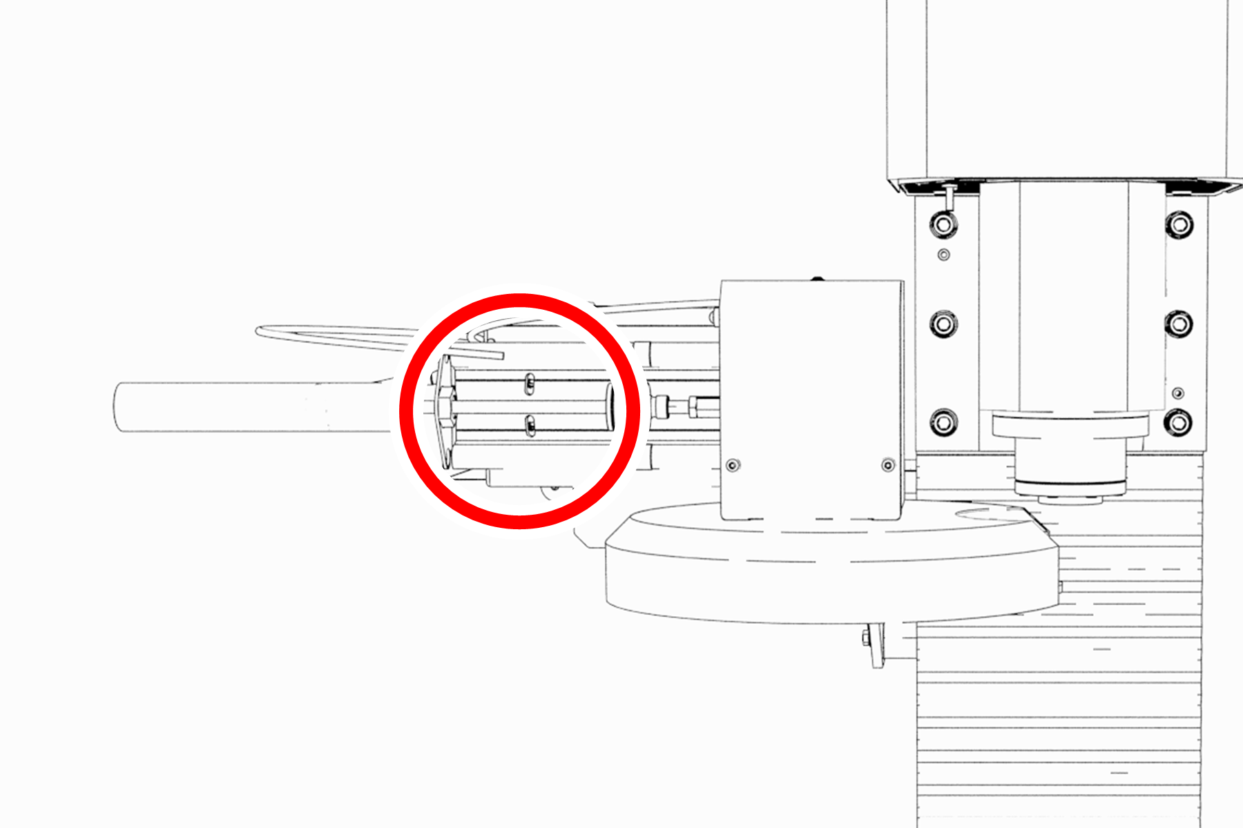

  2. Verify that the linear bearing on the ATC is flush with the ATC main assembly.
    Linear bearing flush with the ATC main assembly.

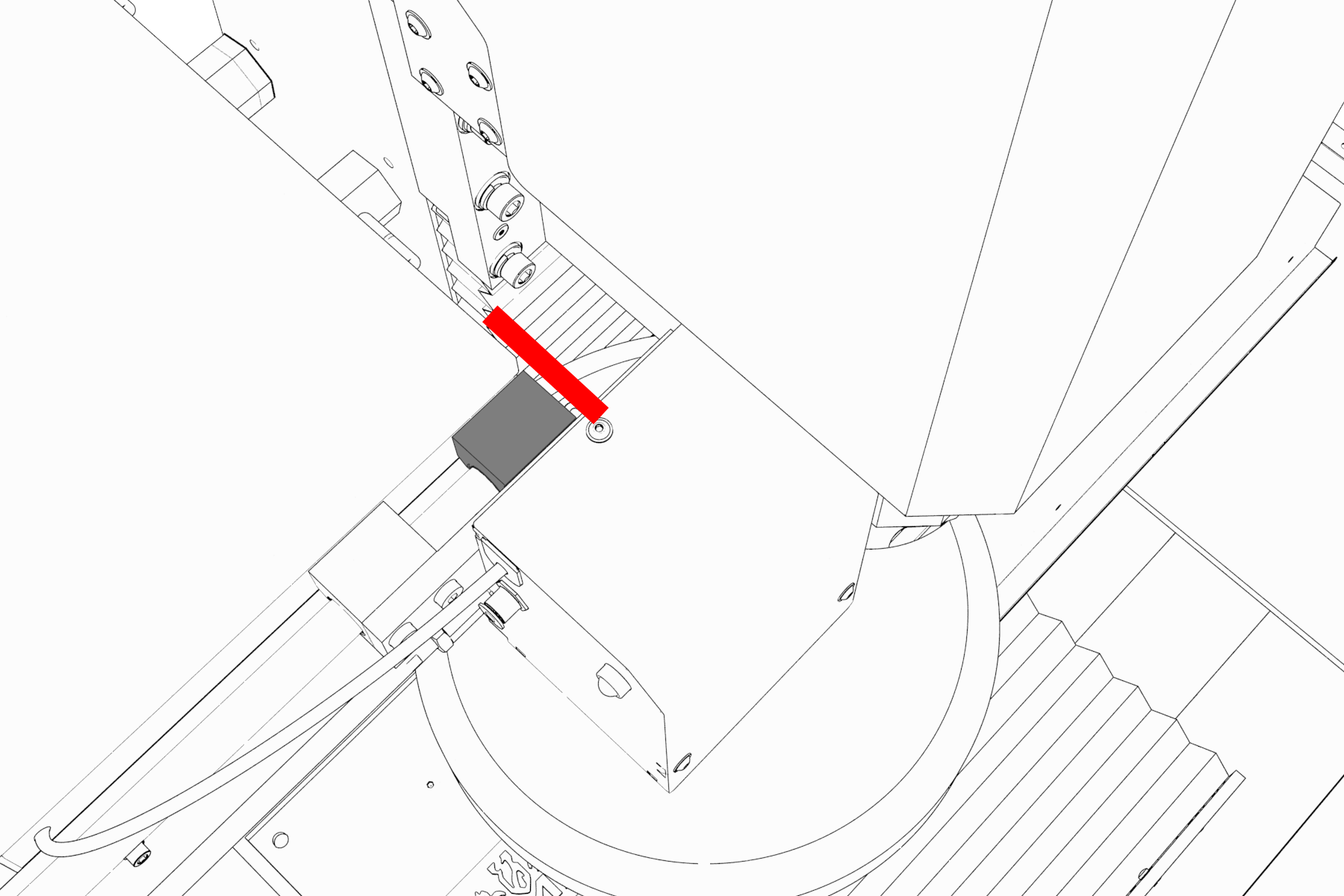

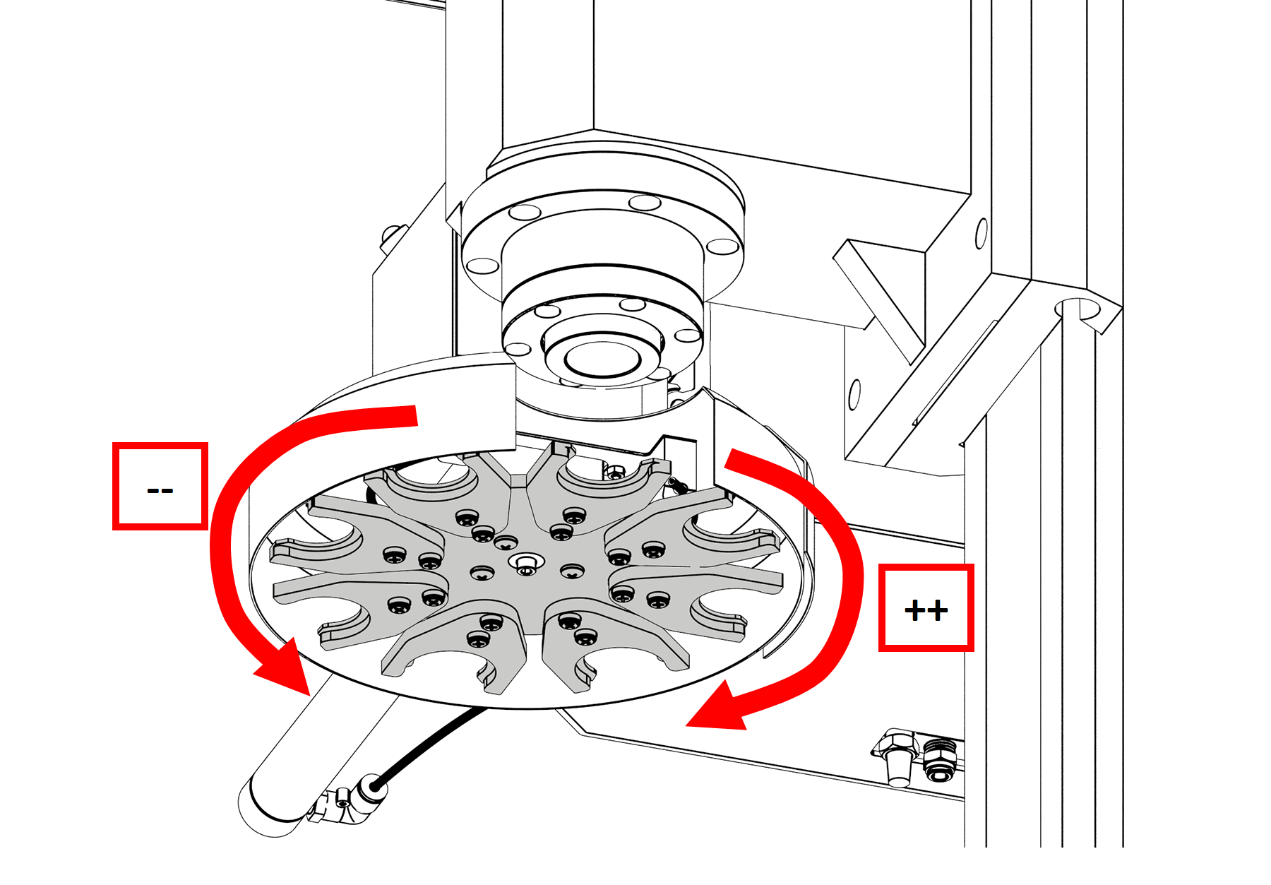

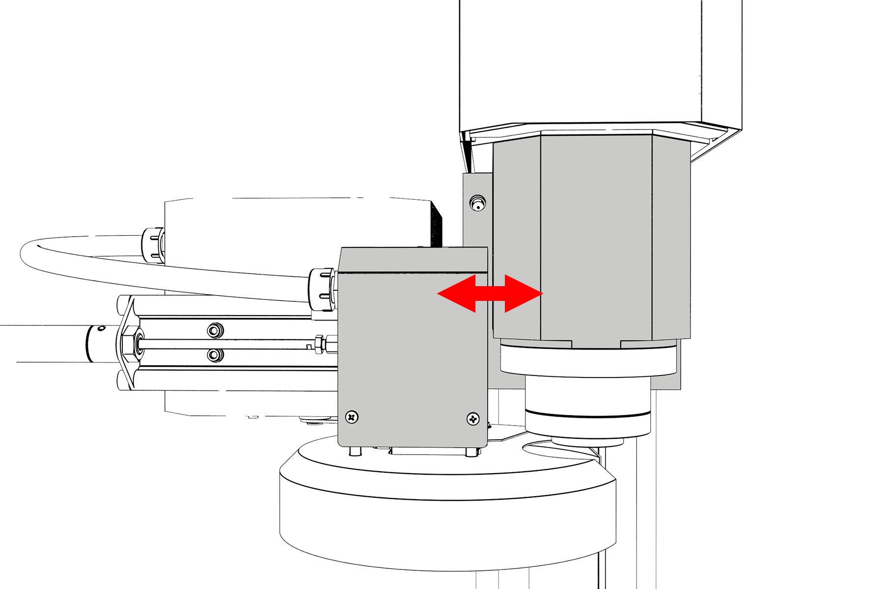

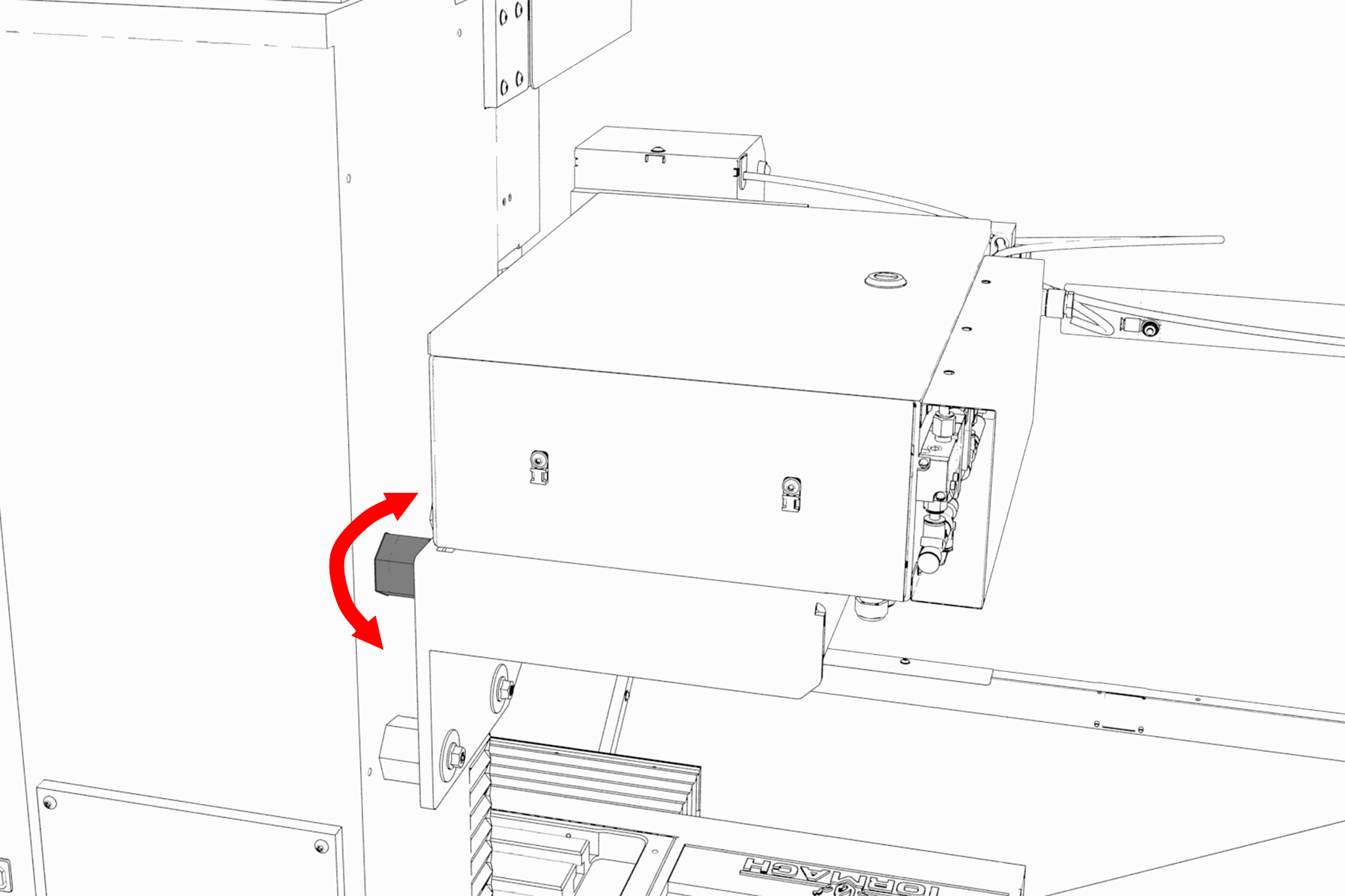

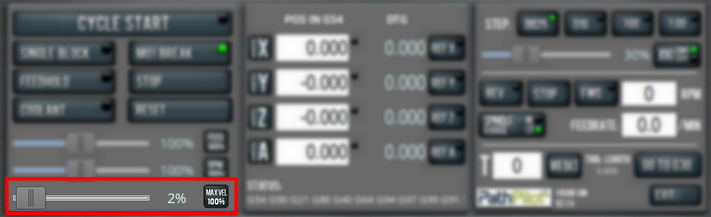

  3. Verify that the ATC is all the way forward (toward the spindle), and then slowly move the Z-axis down (-Z) to examine the clearance of the carousel door opening.
  4. Verify that the carousel door opening is approximately equal to the front back and left of the spindle mounting flange:
    • If the carousel door opening is approximately equal, go to Step 8.
      Distance between the carousel door opening and the spindle mounting flange.
    • If the carousel door opening must be adjusted, go to Step 5.
  5. Loosen the four socket head cap screws that secure the ATC main assembly to the mounting bracket with a 6 mm hex wrench.
    Socket head cap screws securing the ATC main assembly to the mounting bracket.
  6. Adjust the carousel door opening as required:
    • If the Carousel Door Opening is Contacting the Front Pivot the ATC around the locating pin on the bottom of the mounting bracket toward the front of the machine (closer to you).
    • If the Carousel Door Opening is Contacting the Back Pivot the ATC around the locating pin on the bottom of the mounting bracket toward the back of the machine (closer to the machine column).
    • If the Carousel Door Opening is Contacting the Left Loosen the four flange nuts that attach the mounting bracket to the column to move the bracket forward or backward.
      Moving the ATC mounting bracket could change the position of the tilt standoff (on the Z-column). If you move it, you must verify that the ATC is still correctly installed; go to Install the 1100M/770M Automatic Tool Changer.
      Repeat this step as needed.
  7. Tighten the socket head cap screws and the flange nuts (if you loosened them in Step 5).

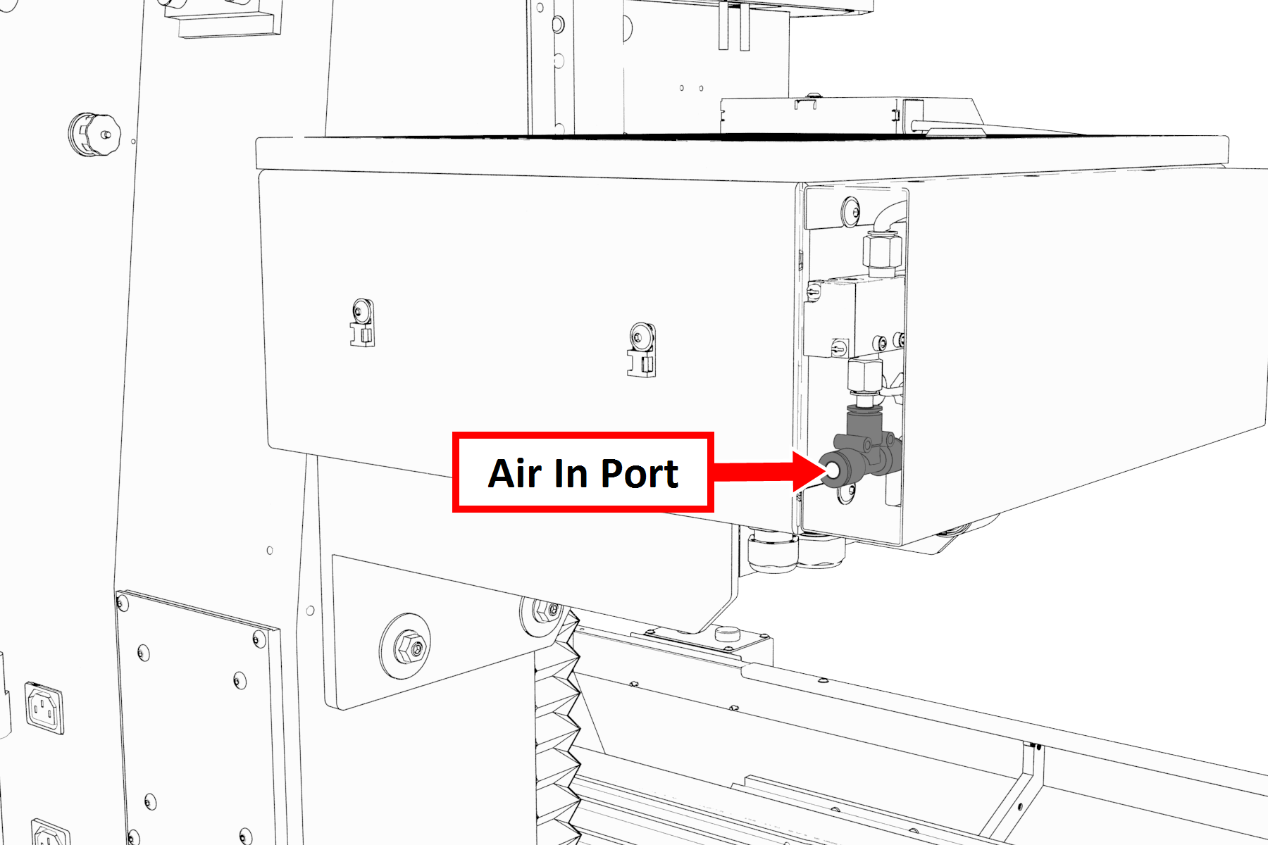

Make Air Connections
  2. Route the loose ends of the two 1/4 in. plastic tubes connected to the ATC main assembly through the enclosure knockout, up the energy chain, and toward the Power Drawbar.
    Crush Hazard: If the ATC isn't completely retracted, it could move once the air is reconnected. When you reconnect the air, you must keep your hands away from the ATC.
  3. Connect the loose ends of the 1/4 in. plastic tubes in the following order:
      Air in port in the ATC main assembly.
    4. If you haven't already done so, connect your shop's air supply to the FRL.

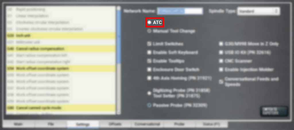

  3. From the PathPilot interface, on the Settings tab, select the ATC radio button.
    ATC radio button on the Settings tab.
    If prompted, you may need to update the firmware for the ATC. Follow the on-screen instructions.

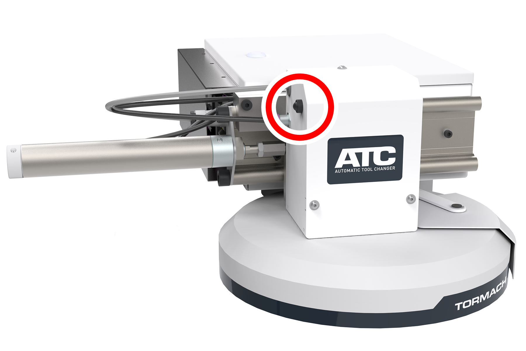

    1. Push and hold the colletdrawbar open button on the side of the ATC.
      Collet Drawbar open button on the side of the ATC.
      The colletdrawbar opens.
    2. Load a tool into the spindle.
    3. Release the button.
      The colletdrawbar closes.

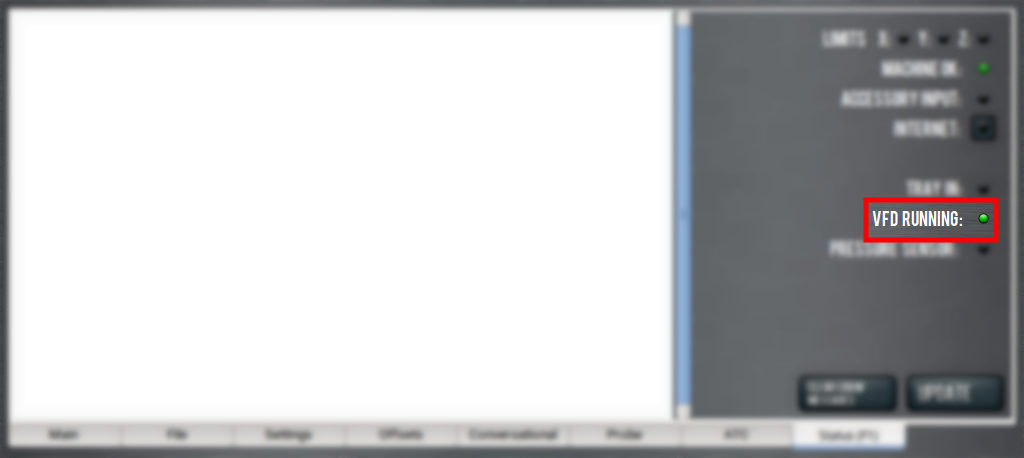

  7. From the Status tab, make sure that the VFD Running green light comes on.
    VFD Running light on the Status tab.
    If the VFD Running light did not come on in the previous step, we can help. Email support@tormach.com to contact Tormach Technical Support for guidance on how to proceed.

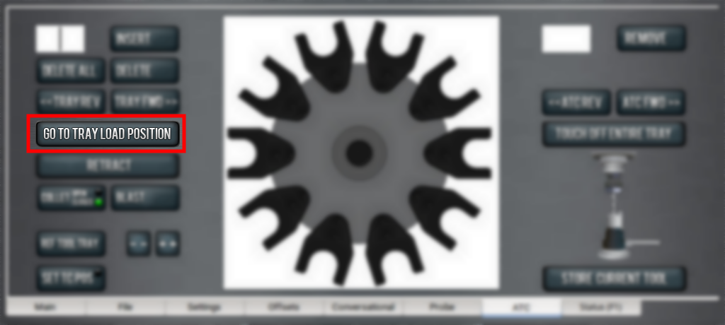

Make Final Alignments

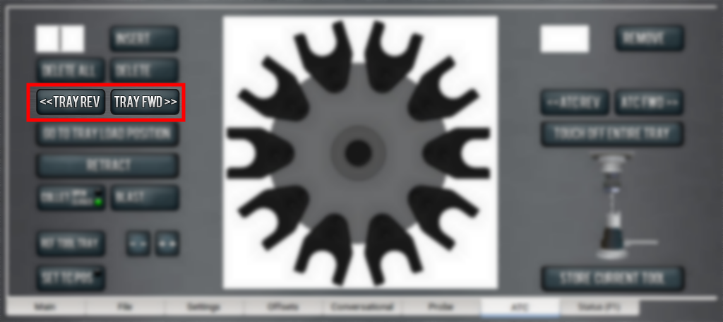

  1. Verify that there's no tool in the spindle.

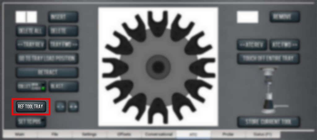

  2. From the PathPilot interface, on the ATC tab, select Ref Tool Tray.
    Ref Tool Tray button on the ATC tab.
    The tool tray spins.
    You're only required to reference the tool tray once, unlike the mill axes’ referencing procedure.
  3. Select Go to Tray Load Position.
    Go to Tray Load Position button on the ATC tab.
  4. When prompted, select OK.
    The tool tray moves forward.

    • Adjust the Alignment of the Tool in the Y Direction (toward or away from the Z column) Determine if the tray must move clockwise or counterclockwise. From the PathPilot interface, in the ATC tab, either select -- to step the tool tray counterclockwise or ++ to step the tool tray clockwise.
      Moving the tool tray clockwise or counterclockwise.
    • Adjust the Alignment of the Tool in the X Direction (left or right) Determine if the tray must move left or right. Use two wrenches to loosen the jam nut on the end of the cylinder rod, making sure that you don't spin the rod end when adjusting the jam nut. Then, either turn the rod end one-half turn further on to the cylinder rod to move the tool tray to the left, or turn it one-half turn off of the cylinder rod to move the tool tray to the right. Once finished, tighten the jam nut.
      Moving the tool tray left or right.
    Repeat adjustments until the tool's shank is concentric with the collet in the spindle.

  1. From the PathPilot interface, select Go to Tray Load Position.
  2. Slowly jog the Z-axis down (-Z) over the tool’s shank.
  3. Verify that the tool’s shank moves freely into the collet.

There's a small amount of rotational play built into the Automatic Tool Changer (ATC) carousel. This play allows for some misalignment during tool changes, and you must adjust for it in both directions. The taper on the tool shank also helps align the tool during a tool change.
To adjust for rotational play:
  1. From the PathPilot interface, on the ATC tab, select Tray Fwd to rotate the tray clockwise (forward) one full tool slot.
    Tray FWD and Tray REV buttons on the ATC tab.
  2. Select Tray Rev to rotate the tray counterclockwise (backward) one full tool slot.
  3. Verify that the tool’s shank is aligned with the collet in the spindle.

  5. From the PathPilot interface, on the Main tab, drag the Maxvel Override slider to the left. This reduces the maximum velocity by the percentage shown.
    Maxvel Override slider on the Main tab.
  6. Do a test tool change. Because the maximum velocity is reduced, it's easier to verify the alignment of the ATC and stop the machine if further adjustment is required.
    Use the Spacebar key to pause the tool change, if needed.
